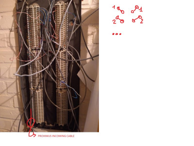

I am getting pretty bad DL and UL speeds (have not checked speeds in over 8-months, so not sure when the issue started). Looking for tips on how to troubleshoot the issue. I have not contacted Proximus yet, but planning to do so after some troubleshooting steps. I have also attached historical speed tests I run on DSLreports.com.
Thank you!
[edit] I have rebooted the modem a few times, but get the same poor results after.
