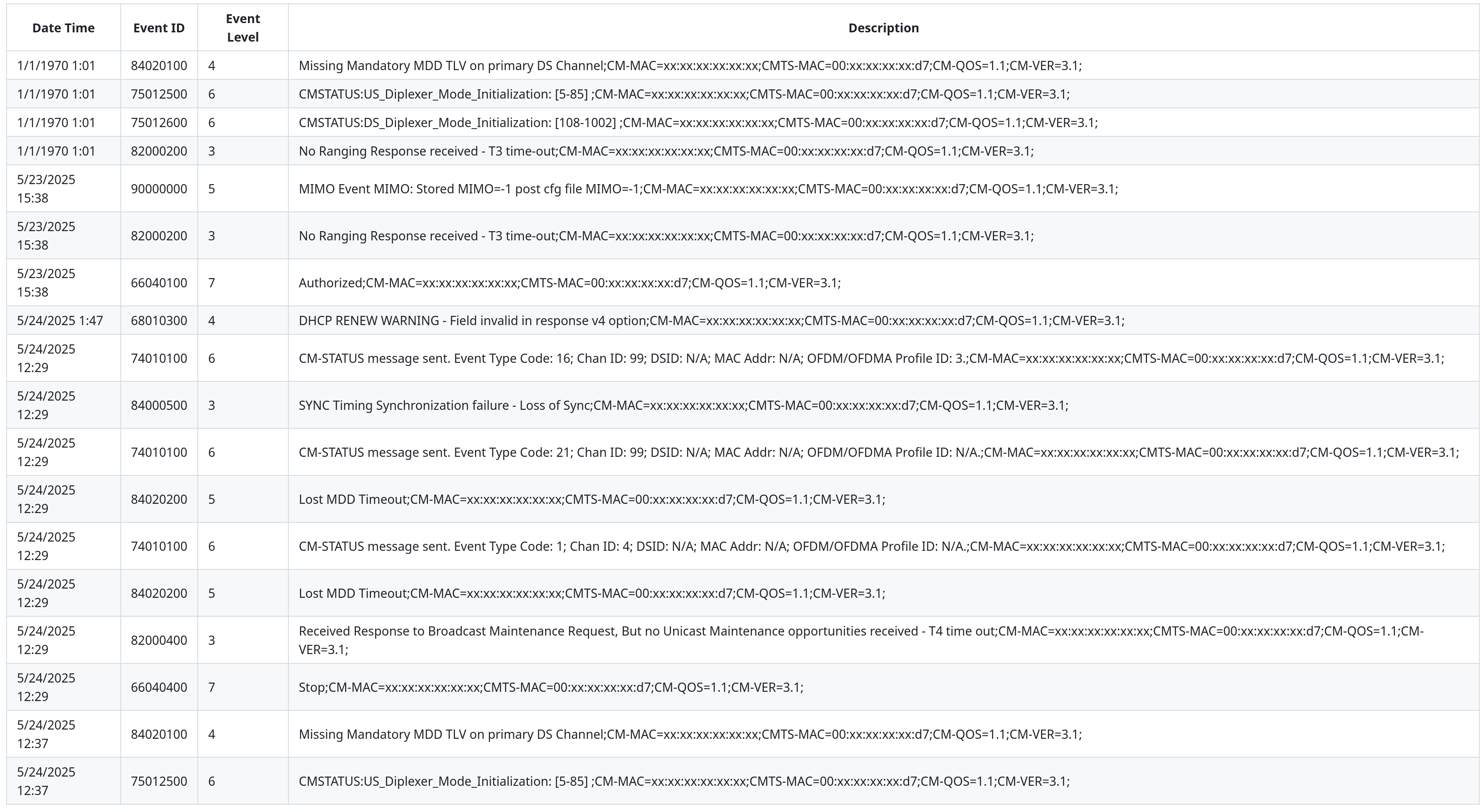

Toegevoegd na 16 uren 19 minuten 56 seconden:
Bij deze een snippet uit mijn logs
| Date Time | Event ID | Event Level | Description |
| 1/1/1970 1:01 | 84020100 | 4 | Missing Mandatory MDD TLV on primary DS Channel;CM-MAC=xx:xx:xx:xx:xx:xx;CMTS-MAC=00:xx:xx:xx:xx:d7;CM-QOS=1.1;CM-VER=3.1; |
| 1/1/1970 1:01 | 75012500 | 6 | CMSTATUS:US_Diplexer_Mode_Initialization: [5-85] ;CM-MAC=xx:xx:xx:xx:xx:xx;CMTS-MAC=00:xx:xx:xx:xx:d7;CM-QOS=1.1;CM-VER=3.1; |
| 1/1/1970 1:01 | 75012600 | 6 | CMSTATUS:DS_Diplexer_Mode_Initialization: [108-1002] ;CM-MAC=xx:xx:xx:xx:xx:xx;CMTS-MAC=00:xx:xx:xx:xx:d7;CM-QOS=1.1;CM-VER=3.1; |
| 1/1/1970 1:01 | 82000200 | 3 | No Ranging Response received - T3 time-out;CM-MAC=xx:xx:xx:xx:xx:xx;CMTS-MAC=00:xx:xx:xx:xx:d7;CM-QOS=1.1;CM-VER=3.1; |
| 5/23/2025 15:38 | 90000000 | 5 | MIMO Event MIMO: Stored MIMO=-1 post cfg file MIMO=-1;CM-MAC=xx:xx:xx:xx:xx:xx;CMTS-MAC=00:xx:xx:xx:xx:d7;CM-QOS=1.1;CM-VER=3.1; |
| 5/23/2025 15:38 | 82000200 | 3 | No Ranging Response received - T3 time-out;CM-MAC=xx:xx:xx:xx:xx:xx;CMTS-MAC=00:xx:xx:xx:xx:d7;CM-QOS=1.1;CM-VER=3.1; |
| 5/23/2025 15:38 | 66040100 | 7 | Authorized;CM-MAC=xx:xx:xx:xx:xx:xx;CMTS-MAC=00:xx:xx:xx:xx:d7;CM-QOS=1.1;CM-VER=3.1; |
| 5/24/2025 1:47 | 68010300 | 4 | DHCP RENEW WARNING - Field invalid in response v4 option;CM-MAC=xx:xx:xx:xx:xx:xx;CMTS-MAC=00:xx:xx:xx:xx:d7;CM-QOS=1.1;CM-VER=3.1; |
| 5/24/2025 12:29 | 74010100 | 6 | CM-STATUS message sent. Event Type Code: 16; Chan ID: 99; DSID: N/A; MAC Addr: N/A; OFDM/OFDMA Profile ID: 3.;CM-MAC=xx:xx:xx:xx:xx:xx;CMTS-MAC=00:xx:xx:xx:xx:d7;CM-QOS=1.1;CM-VER=3.1; |
| 5/24/2025 12:29 | 84000500 | 3 | SYNC Timing Synchronization failure - Loss of Sync;CM-MAC=xx:xx:xx:xx:xx:xx;CMTS-MAC=00:xx:xx:xx:xx:d7;CM-QOS=1.1;CM-VER=3.1; |
| 5/24/2025 12:29 | 74010100 | 6 | CM-STATUS message sent. Event Type Code: 21; Chan ID: 99; DSID: N/A; MAC Addr: N/A; OFDM/OFDMA Profile ID: N/A.;CM-MAC=xx:xx:xx:xx:xx:xx;CMTS-MAC=00:xx:xx:xx:xx:d7;CM-QOS=1.1;CM-VER=3.1; |
| 5/24/2025 12:29 | 84020200 | 5 | Lost MDD Timeout;CM-MAC=xx:xx:xx:xx:xx:xx;CMTS-MAC=00:xx:xx:xx:xx:d7;CM-QOS=1.1;CM-VER=3.1; |
| 5/24/2025 12:29 | 74010100 | 6 | CM-STATUS message sent. Event Type Code: 1; Chan ID: 4; DSID: N/A; MAC Addr: N/A; OFDM/OFDMA Profile ID: N/A.;CM-MAC=xx:xx:xx:xx:xx:xx;CMTS-MAC=00:xx:xx:xx:xx:d7;CM-QOS=1.1;CM-VER=3.1; |
| 5/24/2025 12:29 | 82000400 | 3 | Received Response to Broadcast Maintenance Request, But no Unicast Maintenance opportunities received - T4 time out;CM-MAC=xx:xx:xx:xx:xx:xx;CMTS-MAC=00:xx:xx:xx:xx:d7;CM-QOS=1.1;CM-VER=3.1; |
| 5/24/2025 12:29 | 66040400 | 7 | Stop;CM-MAC=xx:xx:xx:xx:xx:xx;CMTS-MAC=00:xx:xx:xx:xx:d7;CM-QOS=1.1;CM-VER=3.1; |
| 5/24/2025 12:37 | 84020100 | 4 | Missing Mandatory MDD TLV on primary DS Channel;CM-MAC=xx:xx:xx:xx:xx:xx;CMTS-MAC=00:xx:xx:xx:xx:d7;CM-QOS=1.1;CM-VER=3.1; |
| 5/24/2025 12:37 | 75012500 | 6 | CMSTATUS:US_Diplexer_Mode_Initialization: [5-85] ;CM-MAC=xx:xx:xx:xx:xx:xx;CMTS-MAC=00:xx:xx:xx:xx:d7;CM-QOS=1.1;CM-VER=3.1; |

Das inderdaad bijna of helemaal het zelfde als wat ik krijg met mijn modem. Toch is mijn vermoedens dat er iets intern bij Orange fout gaat waardoor wij die modems niet kunnen registreren.

blixem schreef: 2 maanden geleden Das inderdaad bijna of helemaal het zelfde als wat ik krijg met mijn modem. Toch is mijn vermoedens dat er iets intern bij Orange fout gaat waardoor wij die modems niet kunnen registreren.
Werner Electronic bevestigde mij inderdaad dat er niks mis is het toestel en dat de modem correct werd geactiveerd, maar dat er dus nog een technisch issue is aan de kant van Orange. Je zou denken dat het device dus niet supported is door Orange, maar bij mij heeft het al 3 maand zonder problemen gewerkt.
Orange van hun kant weer (alvast de L1 servicedesk) trekt hun handen er van af. "Het is een privé modem dus we kunnen geen technische support leveren."
Ik had deze morgen blijkbaar eentje vast die al eens had gesproken met een andere klant die dezelfde activatie-issues had (misschien een van de mensen van hier op Userbase) en ze zou toen diezelfde uitleg hebben gekregen van de Orange back-office.
Ik blijf alvast Orange contacteren, kwestie van het dossier bij hun aan te dikken. Hopelijk raak ik zo uiteindelijk voorbij L1 support en kom ik ooit bij de juiste persoon terecht.
