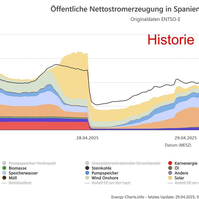

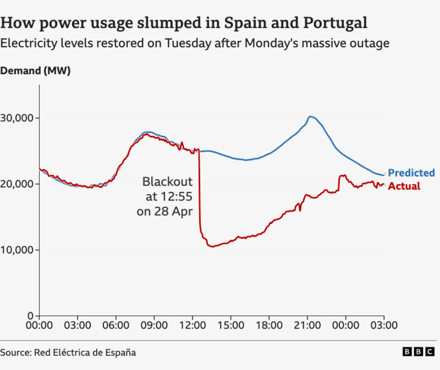

Grafiek blackout en herstel:
Wat meer detail over hoe ze de boel terug opstarten: https://www.bbc.com/news/articles/c175ykvjxyeo
Oorzaak - voorlopig -: REE said it had identified two incidents of power generation loss, probably from solar plants, in Spain’s southwest that caused instability in the electric system and led to a breakdown of its interconnection with France.
