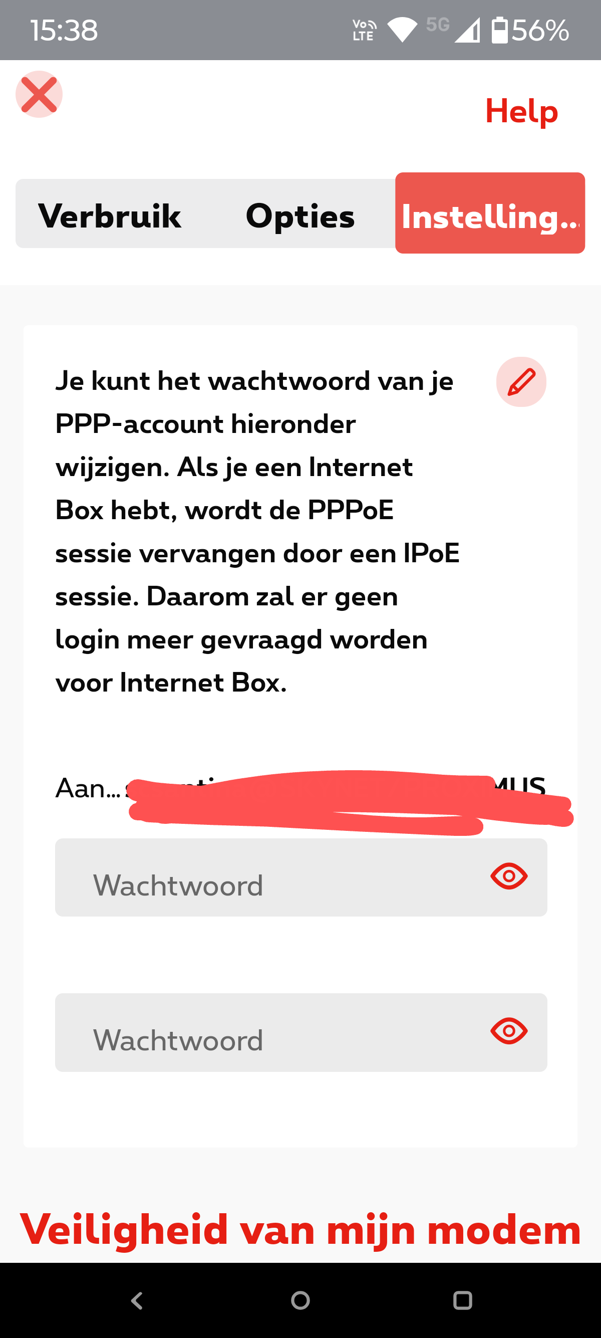

this is what it says in my app when I want to change my password
So yoy need an internet box
