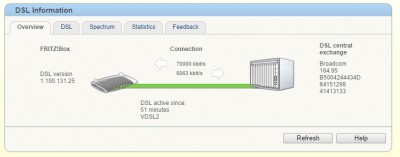

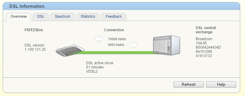

i could not resist temptation. bb3 connected, i got repair profile 7/0.5... called belgacom, uhm, proximus, and guy on the phone did reset my line. After 10 min, bb3 synced at 70/6. I connected FB and got this:
[img]vdsl.jpg[/img]
Bit risky, but finally bboxes are going in the closet on the bottom shelf . Interesting is that my Fritz!Box 7490 has FW 6.04 (so not the one that is Belg..Proximus approved, 6.06)
[img]vdsl.jpg[/img]
I was celebrating too early.... After couple of hours, DSL live went down, Fritz Box could not sync. I put back Bbox 3 and I am back to repair profile...
